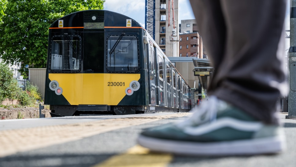

A trip on GWR's Battery Electric Train - 17/12/2024
Posted by grahame at 09:54, 18th December 2024
Great Western Railway have been testing their "Battery Electric Train" on the line from West Ealing to Greenford for a while now, and they invited a group of stakeholder along to see it, hear about it, and have a ride yesterday.
The test train runs from West Ealing in a side platform away from the main line - and that was where I found it; it's a 3 carriage conversions of an old district line underground (similar conversions on the Isle of Wight and from Wrexham to Birkenhead). Smart it looks too.
The challenges with a battery train include the distance it can travel on a charge, and the time it takes to recharge.  This train has proven capable of running over 100 miles on a single charge, but is normally used over a much shorter distance.  "Fast Charging" at West Ealing means than in its three minutes turn around, it can take in enough charge for the next round trip of around 25 minutes, with three intermediate stops each way, to Greenford.
That charging rate is more than the local grid could cope with, so there are containers of batteries beside the track which are charged much more gradually when the train is not there, ready to "thump" power into the train when it's turning around there.  I understand that less that 10% of the battery charge is used on each trip, and with recharging at 65% of the maximum possible that 10% is replenished in the three minutes. Screens and graphics on the test train were showing that it had been working with batteries charged to between 75% and 85% all day.
The journey itself - uneventful (as a train journey should be). We stopped at each intermediate station - Drayton Green, Castle Bar Park and South Greenford, passing the normal passenger service going the other way, before pulling into the single platform for the GWR Greenford Branch at Greenford. And back that same way, meeting up with many long term friends and a really useful day.  I hung around at West Ealing to get few photos of that charging ramp.
