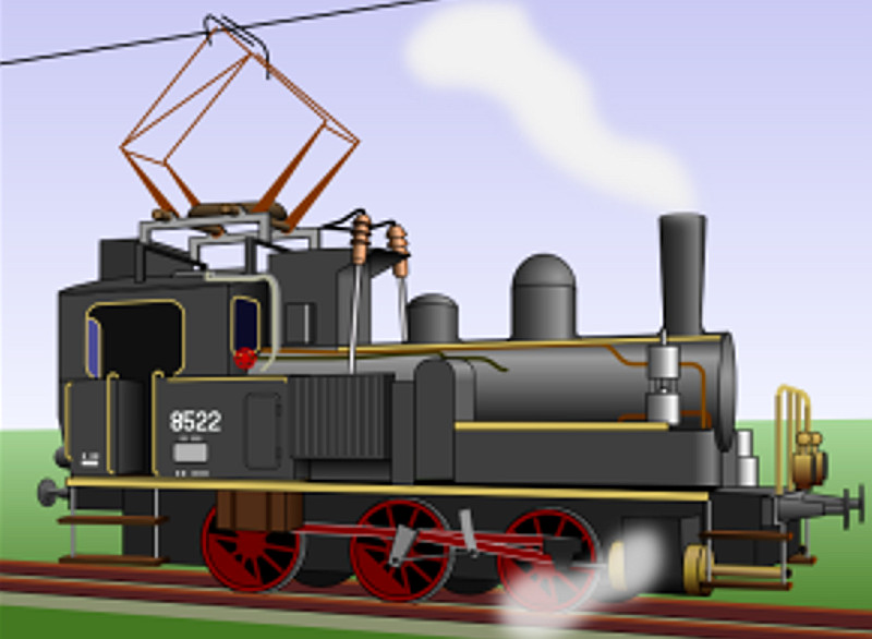

In an attempt to save on coal the Swiss Federal Railways fitted two small 0-6-0 steam shunters of class E 3/3 with a pantograph. Power was taken from overhead lines (15 kV, ​16 2⁄3 Hz), and fed to heating elements, via two transformers rated together at 480 kW. The modified E 3/3 8521 was brought into use on 13 January 1943; 8522 followed on 11 February 1943. They could run up to 20 minutes without power supply, like a fireless locomotive, once the boiler had been charged to full pressure.
There is a YouTube clip featuring these here.

In an attempt to save on coal the Swiss Federal Railways fitted two small 0-6-0 steam shunters of class E 3/3 with a pantograph. Power was taken from overhead lines (15 kV, ​16 2⁄3 Hz), and fed to heating elements, via two transformers rated together at 480 kW. The modified E 3/3 8521 was brought into use on 13 January 1943; 8522 followed on 11 February 1943. They could run up to 20 minutes without power supply, like a fireless locomotive, once the boiler had been charged to full pressure. The firebox was retained, usually keeping hot embers, with a classic fire for longer operation on non-electrified tracks. The water circulation pump, the control circuit and the lighting were powered by a battery that was charged from a rectifier fed by one of the transformers.
Slightly modified from image by W.Rebel under Creative Commons 3.0 license
The "up to 20 minutes without power" could be significant - that should be plenty long enough to get through the Severn tunnel ... class 803, electric with steam power for short sections hard to electrify ...
